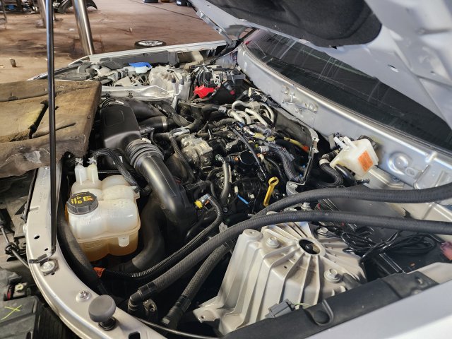

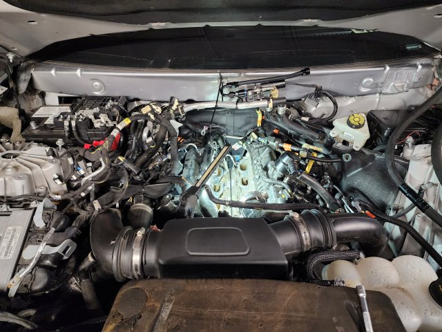

Moved injector from 6 to 1. Misfire followed to 1. Installing new set of injectors this morning. Hopefully that will end this saga. I'll post more in depth once I can breath again. Have fun pics of the engine all taken apart as well. Stay tuned.
