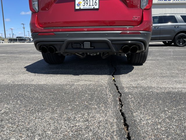

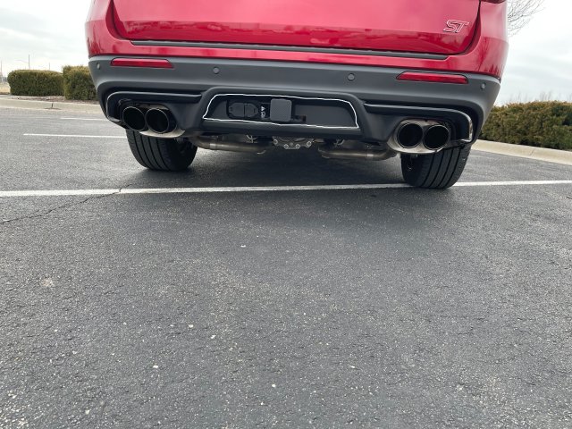

Came across this video. Sounds pretty good. Has anyone here actually installed this system on thier ST? Would love to see more photos of how it actually looks from the rear of the ST low down. Magnaflow has one photo of a silver ST but its too far away to clearly see the parts hanging beneath the spare tire.

Other things I have gleaned, over time, regarding the Magnaflow #19515 exhaust system. Multiple vehicles I have seen with this exhaust system (equipped with SPD downpipes) have the tail pipes sticking out about an extra half inch versus this system with OEM downpipes. With OEM downpipes the etched MF on the tail pipe ends only protrudes so you see the M whereas the SPD equipped vehicles with this exhaust system the etched MF protrudes fully. The second item is when the air deflector that fits between the OEM mufflers is installed with the Magnaflow #19515 exhaust system the driver side clears with no contact and the passenger side rubs the exhaust pipe for about a square inch of contact. Took the vehicle on the road for two hour drive and the air deflector did not melt so there must be enough air flow combined with being in the cooler portion of the exhaust system. The air deflector helps clean up the rear view of the vehicle. I does look pretty mean from a half block away.
