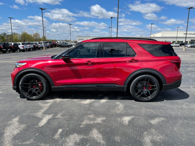

I had the Pirelli Scorpion Zero Asimmetrico 305/35/22 with 22x10.5 +30 wheels plus H&R springs (SHOWN). Rear treads are down to 6/32" after 7,000 miles, fronts about 8/32". There is some tram lining or road following with the wider tires so this time I went with Pirelli Scorpion Zero Asimmetrico 295/40/22 to get a slightly narrower tire plus a little more sidewall to cushion the ride over road joints plus add a little more beef to the sidewall visually. We'll see how that works out.

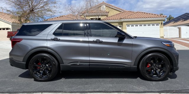

Here’s mine with Steeda springs and Steeda 1.25” spacers in the rear only.

I wanted to do 1” in the front, but didn’t like the idea of cutting the studs, so I planned on doing 1.25” all the way around. But they stuck out too far for my liking in the front, so I left them off.

Thank you! I wasn’t sure if they’d be low enough for me and I started to have doubts before we installed them, but I’m really happy with the way it turned out. I also like the little bit of rake in it for when I have to hook the trailer up to it..
Exhaust is Thermal 2.5” with CVF downpipes.
