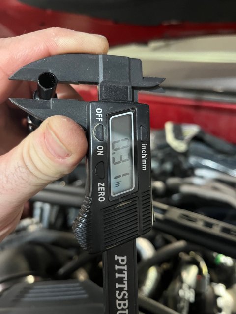

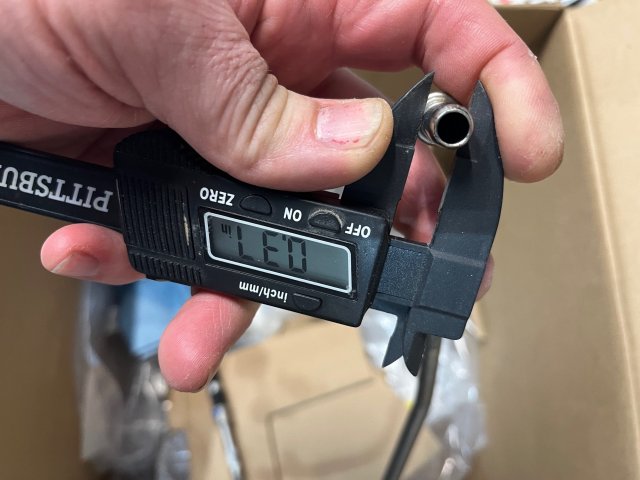

Anyone doing this, the male to female is a 3/8”…. Not a 5/16”. The 5/16” one is too small and does not fit properly.
203
101
30122 Woodward Ave
Measure ID not OD. It's for sure 5/16 or AN6.

Thread Starter #23
The part you had linked is 5/16” OD which was too small. I reordered the 3/8” OD (5/16” ID) piece and will try that tonight.

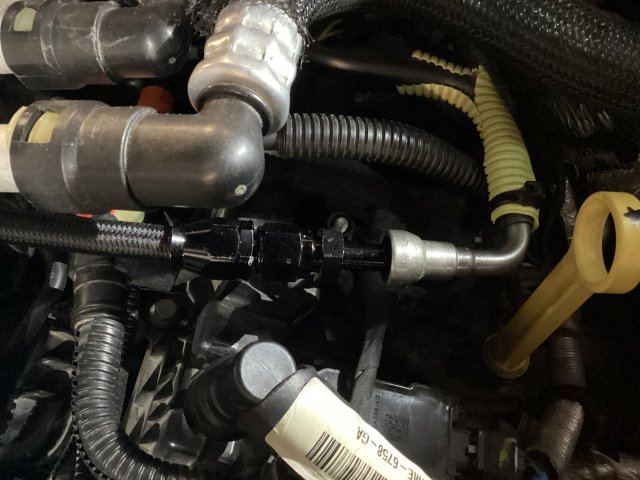

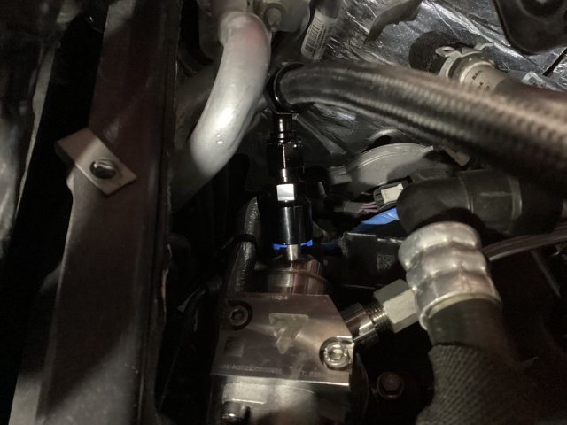

Okay, all put back together and started… same leak in the same spot???? WTF! Again, it’s not a lot of gas, just a drip or two but why is this still leaking?

Okay, finally have an answer on this… manufacturer defect! Per Nostrum there is a leak in the weld around the inlet pipe.
Fantastic news for me as per Nostrum they don’t have any pumps on hand to swap it and won’t until some time in August. Was told on Tuesday they were sending it in some time next week (didn’t know when) so it can be re-welded. Spoke with rep today and he had no updates as to when it was being sent next week and was told it SHOULD be welded the following week some time but know ETA… I guess I will get it back whenever they get to it…
Just my luck, I spend thousands on a stage 1 kit and get to spend hundreds more on Uber rides to work for 2+ weeks when the pump doesn’t work. Total BS.
