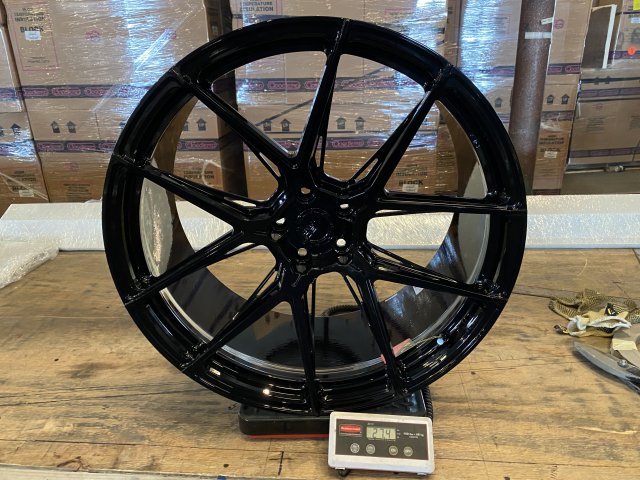

BC Forged is delivering in 5 weeks or less. These are my 22x10.5’s from them at 27.4lbs 7C0A4FE3-CC46-40FF-9AD4-C355A3A70835.jpeg

BC Forged is delivering in 5 weeks or less. These are my 22x10.5’s from them at 27.4lbs View attachment 1567
they are really nice and the weight is impressive for the size
I'll check out that brand, hopefully they have 21 or 20" too.
best selection I've seen so far

super legit wheels, thanks for the suggestion
I'm going to grab a set
