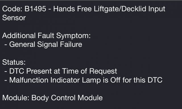

Did the plug removal trick. Does anyone get a code when they check with Forscan?
2,139
1,085
2026 Explorer ST
#36
Is it showing up on the dashboard or just when you scan?
no dashboard lights. just scan. not a big deal, just wondering.
