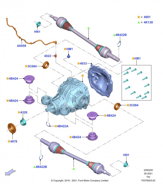

Forgive my ignorance, what exactly does this diagram show? Does this mean that a three bolt is just as good as a four bolts or does this indicate that there actually are four bolts but we can’t see the fourth bolt I’m trying to understand if it’s OK for me to purchase a second ST that is equipped with the three bolt pattern that we see on some of the year 21 and 22 models.
Bolt HB1 and its mount are missing.
Ok thank you for clearing this up. Do you or does anyone know if this will be remedied by Ford? I’m not mechanically inclined, why can’t a bolt simply be added by a ford technician? I’m asking all these questions cuz I currently have a ‘21 st but have 4 bolts. I’m looming to get another one since my wife loves the ride and I’ll be traveling more and taking my car with me. I was planning on getting a ‘21 but so far have only seen them with 3 bolts. 2 dealerships out of 10 that I’ve looked at have told me that they can promise me a fix for it and that it would have the missing bolt. Is this even possible?

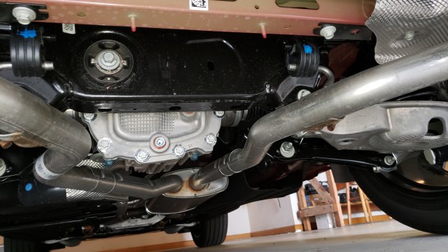

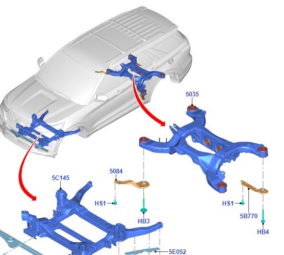

The bolt can't be added, the subframe mount for the bolt was not built into the subframe so the subframe would have to be replaced with one that has the 4th mount. Yes its possible, the replacement subframe MSRP is $1,914.37, not sure about labor, and mounting hardware. I would insist that they include it in your purchase agreement and replace the subframe before you take possession of it and drive it off the lot. If you are going to have it done, also make sure all 10 subframe bracket bolts are installed, mine has 6.

Do you kn
Do you perhaps know the part number of this 2 bolt subframe?
I plan to go to the dealership tomorrow and verify that which part number is actually a 2 bolt then buy one, will post results then.

Think the Sub-frame Part number is one of the following...MB5Z5035J or MB5Z5035H

Spent about an hour on the phone with my local Ford dealership, they tracked down the "J" version and sent me a picture, it only has one bushing, the "J" version is the correct part for a 23 ST. Too much trouble tracking down and verifying a subframe with 2 diff bushings, bought a Stella brace. Will use the money saved to buy a FP tune.
