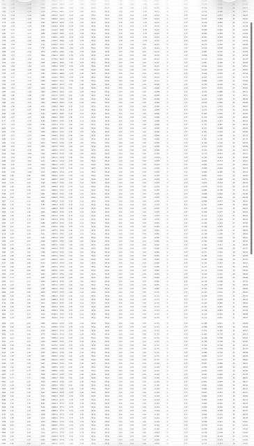

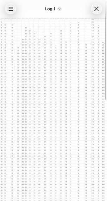

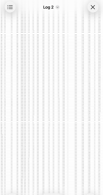

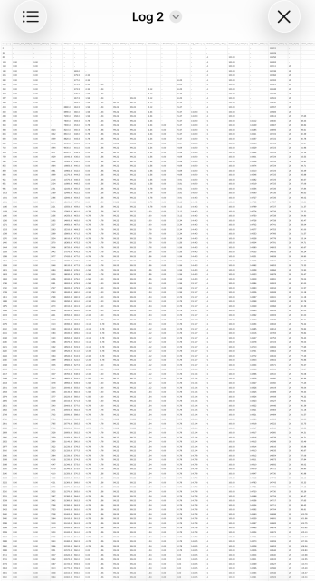

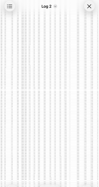

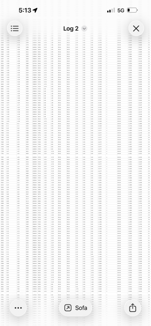

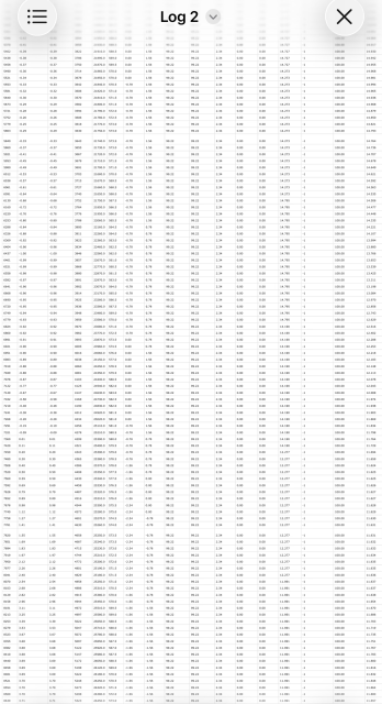

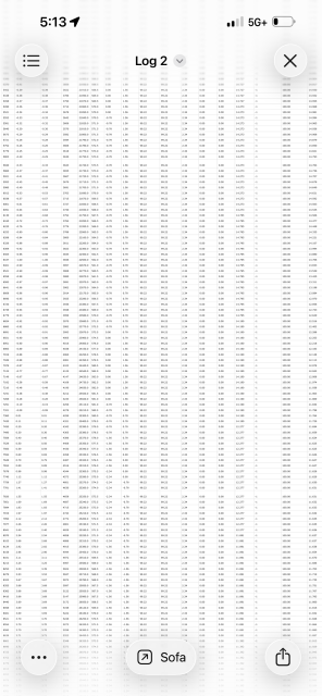

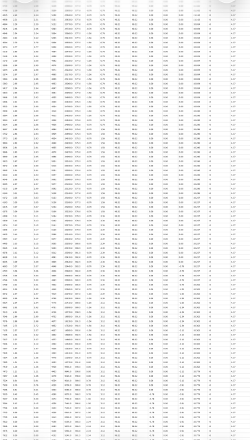

Hi, everyone wasn’t sure which thread to post it in. Mainly was not sure whether the following would be considered normal or trouble?
just looking for some objective feedback.
Current vehicle is explorer st 2025 with around 11,000 miles on it.
OBD Link MX plus with FORScan Lite was used for the logs posted.
I am seeing Knock RET values varying from 2 to 4.5 seen once and mainly when the RPM is over 5000
I am wondering if 2 to 4° knock correction is considered normal on stock? Do these values look like normal ford correction strategies? Is there something
else I should be looking at or considering?

What fuel are you using? OEM intercooler or aftermarket?

Oem intercooler , 93 octane shell / 94 if I can find it but try to ensure it’s top tier

It's not really an apples-to-apples comparison but, looking through some of my old logs with a CVF IC your knock correction numbers are in the normal range.
If E85 is available in your area, you could try adding a few gallons to see if the numbers improve.

Thats good to hear though that it’s in a normal range. Thank you WFO-TSi
I haven’t seen e85 anywhere here near me really in South Jersey. What about an octane booster trial ?
There were a few times some very light ping type noise ( coins or marbles in a can ) kinda sound also heard for a second or two. But not always. Usually comes and goes once every few days only if it goes in that high rpm range and that too not always but that knock correction almost always goes anywhere from 2 to 4 when in that rpm range of 5200-5500.

This is part of the joke of the stock IC, the engine has to detune itself very quickly under WOT / high RPM conditions as to not frag itself to death. Best thing you can do is an aftermarket intercooler instead of futzing with octane boosters and mixing E85 (if you can find it). It will reduce knock under those conditions and allow the engine to maintain parameters higher output for longer periods under spirited driving conditions.
