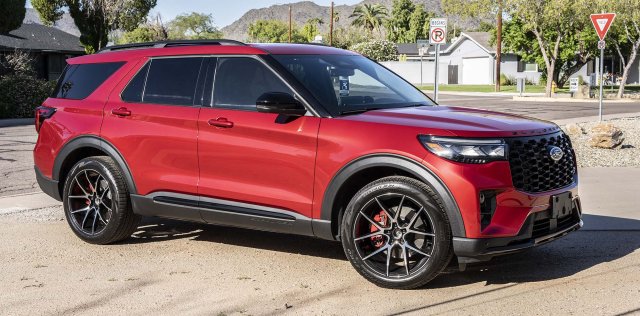

I bought a '25 ST...
...with the 14-speaker B&O system (that was one of my requirements while searching for this car) a month ago and am quite pleased with its overall performance.. The 'soundbar' across the instrument panel has the orchestra in front of me now rather than somewhere around my knees, and the music never sounds low in quality.. The only thing I plan to do with the sound system is to add some 'sub'woofer system to have some bottom-octave energy.
