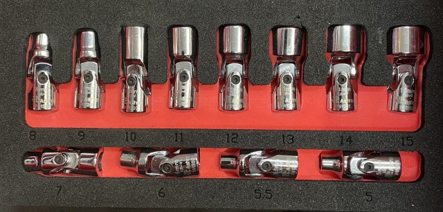

These are the 1/4 drive flex sockets I’m talking about that may work better.
Thanks, I do not have a set of these. I'll pick some up and give them a try and report back if they help.
