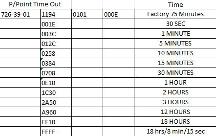

IRC think there is a way in forscan .

If you are talking about the Power Points (Cigarette Lighter) Sockets (please note this is from the 2020 to 2023 ranger forum )
