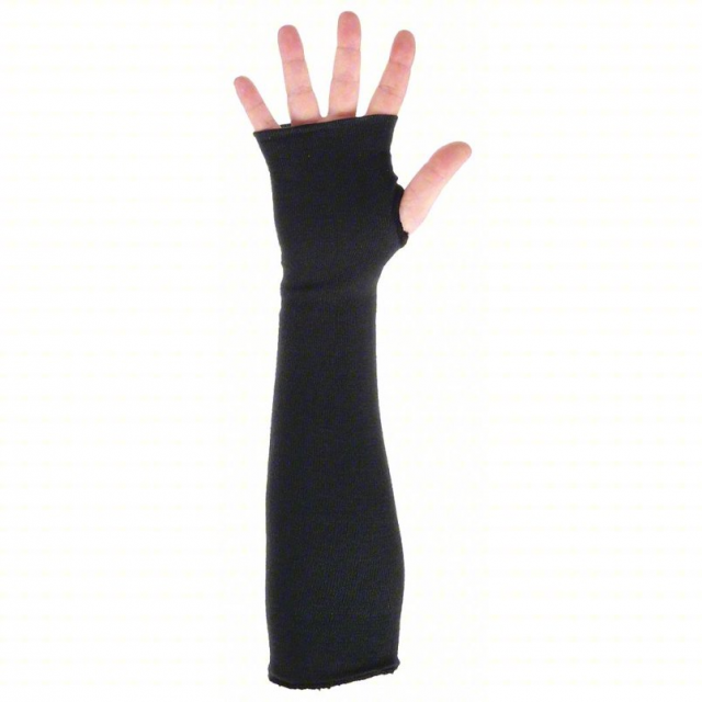

Yeah, you need some protection. The fill cover/bolt can actually be loosened with a 19mm wench above the pipe but sooner or later, you need your bare fingers to further loosen the bolt and to handle it and the dipstick under it. I feel like your wrist area is most likely to contact so have some protection there. I wish I had mechanics gloves with no fingers. No matter what, it's a challenge.

https://www.grainger.com/product/40...VYTmHAx1eWwBHEAQYASABEgL6IfD_BwE&gclsrc=aw.ds
5,627
6,801
Since most people don’t have Kevlar sleeves laying around….just soak a towel in cold water and lay it over the pipe. Don’t overthink it.
