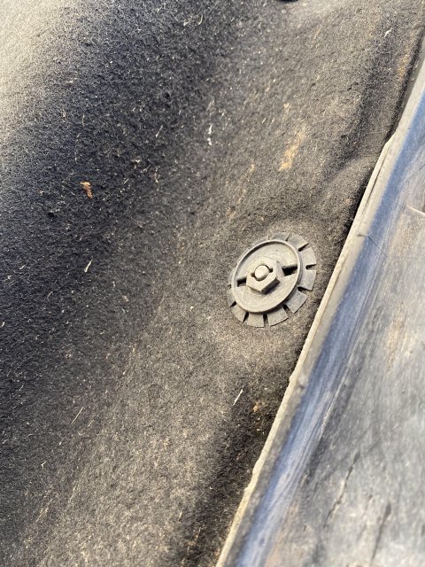

I'm having trouble removing these plastic fake hex nuts. Does anyone have a part number before I snap them all off?

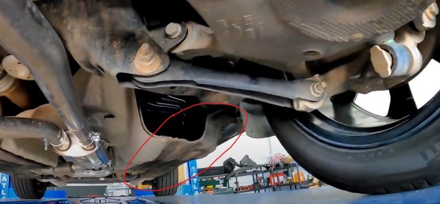

I'm trying to get under this "splash guard" circled in the photo. I don't need the whole thing off, just the outside half. The inside line appears to be riveted to the heat guard.

IIRC, you just untwist as you pull down on them with a needle nose pliers. I've actually replaced a few for not holding well and having the undercarriage cover flap and make noise. really cheap fastener! You can replace them with a stainless fender washer and nut, ideally with spacer.

While we're on the subject, I was under mine for the first time yesterday. What purpose does that splash guard serve. Seems like its huge and takes up a ton of space. Cant imagine it actually keeps any dirt out, if anything id think it would collect it.

This space is where the hybrid battery goes. I guess it was the cheapest solution to just cover that empty space up with a giant splash guard.
