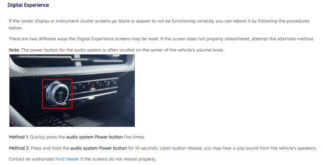

Hello everyone, just as the title states . I have a 2025 ST and the software was just updated but now I can’t reboot by holding the power button anymore. Does anyone now what I can do to reboot it. I hav a glitch with the music app.

hold down stereo power button for 5-10 seconds and then release
I have to do it a couple times a month due to the advance button on the wheel not working.
That doesn’t work anymore

Holding the power button and track forward button at the same time until the screen goes black doesn’t work?

Nope. The only forward button is on the steering wheel. I tried different combos and no go

That doesn't work on the 25s when that button is the one that isn't working due to APIM issues. Holding down power alone works for me and do it too often. I probably need to get newer software on it since it started with the last update the dealer did months ago.

Okay so I guess it was not done installing everything but I also noticed that you can only reset the infotainment only when the car is on park.
