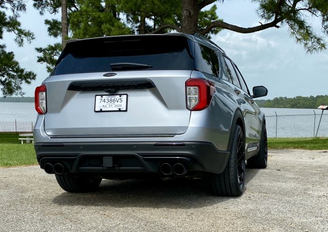

Yes it will fit. The tire sidewall will be roughly 1/4” inside the fender lip. +30-32 is what you would want for a more flush fit.
A 305/40 is gonna be really tight when turning and possibly rub the fender liner but will clear everything else.
A 305/35 will 100% clear everything with no rubbing.

Any 305/35/22 will clear. Pirelli, Continental and Lexani all make that size...the Lexani being cheapest by a large margin. You won’t have any clearance issues...that size tire is .3” shorter than the oem 21’s which is nothing.
If you use camber as another tool to dial in fitment like I do...this is a +30 10.5 on a 305/35 with rear camber set at -.5*
I also have the H&R springs.

I bought some just in case but like I mentioned before I used the rear camber to dial in how the wheel fit. That’s just a preference thing… Has nothing to do with necessity.
