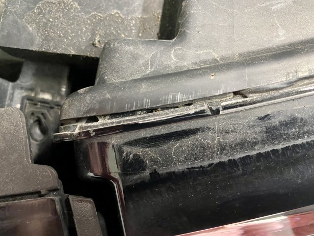

Found some shoddy sealant in the inside top of the driver's headlight. Used some sealant to close it up. 3561F3D3-B62C-4721-BE05-8839F24B4DF8.jpeg
