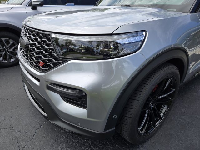

I had vinyl tint wrapped my side markers on my headlights at one point and now decided to take them off but it looks like it took some of the uv coating on headlight off.
Anyone have any idea how to fix the uv coating? Do I need to find a uv coating spray or what? Or if I just leave them will they be fine or will it eventually all peel/chip off and turn my headlights yellow and hazy?
I'm at a loss right now...

Just an update for anyone else that may come across the same issue. I took my vehicle to a body shop and they sanded the headlights down and resprayed the uv coating on the headlights. Looks good as new, maybe even better
