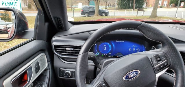

I captured it with photos this time! It has happened once a month for the past 6 months or so. As you can see the lights are on and the switch is "alseep." Once you turn it it resets and you can set it to auto or any position with the LED lit up.

I know this is an older thread, but I recently bought a 2020 ST and am running into this issue. Thought I was somehow bumping or something, but this is happening spontaneously. Was there any resolution? By any chance did you make any changes via FORscan? Asking because I have made a few mods with one of them being the amber+regular DRLs, but I don't think this would have anything to do with it. Planning to back this out and re-evaluate.

My 2020 has no mods and has had this issue about once or twice a year. I never had it looked at under warranty because it's not that big an issue. The lights go off automatically after a while. I just reset the switch which seems to be going to sleep because the LED light is off too until you reset it.I always keep it in AUTO.
1,875
938
For MY2020, the headlight module is known to fail. It may only be seldom, but if the headlights are left on, it could leave you stranded somewhere. Relatively cheap too.
For my 2020 ST, the VIN-checked part was: LB5Z-11654-RC
