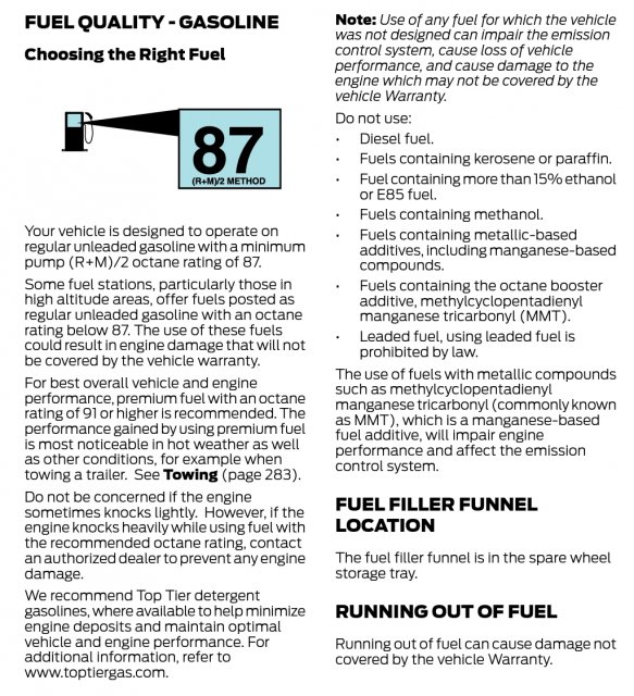

Another question is should I be putting 91 octane or is it safe to use 87? I've been using 91 for a bit ibwouldnt mind dropping to 87 not sure how the car would react

Don’t use 87.. It’s a performance SUV man lol.

Mine runs fine on 87 octane. The cost is so much less here it just makes sense.
I was also mixing it up, until I went for ST experience drive. When I asked about it to the Ford performance team, they suggested premium fuel for the twin turbo engine. Now I fill only premium, but I don't notice any difference between the 87 and 91 on my daily drives in LA.

I figured. I'm sticking to 91 was just confirming since it only show that 87. THANKS!
