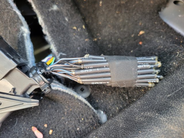

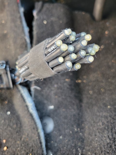

Removing the driver seat is not that hard and I think worth the effort. I also tried reseating the connector first, but it only cleared the codes for a day or two. I had one mounting nut on the module that was not grounded, tightening fixed that. My pin 46 was not connected to ground at all when I tested it (I am assuming this was the major issue). To fix it, I removed the back housing of the connector but did not bother removing the red locking block or depinning the ground wire. I simply cut the black and white wire from the harness and used a waterproof butt crimp to connect the new ground wire. My guess is Ford tells you to depin it to make the crimping and heat shrinking safer/easier but I didn't find it necessary. Soldering would obviously be better if you have the skills and want to take the time. For the new grounding point I used an M6 tap to tap threads into the hole as the first bolt I tried completely stripped out.
