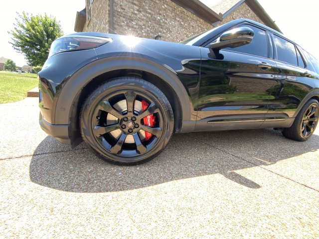

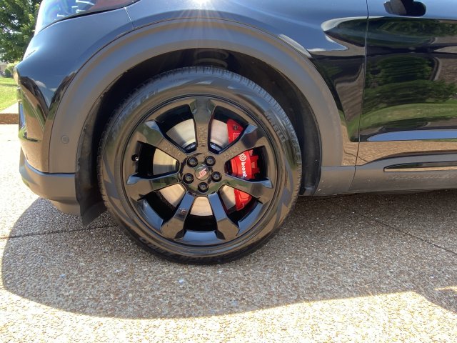

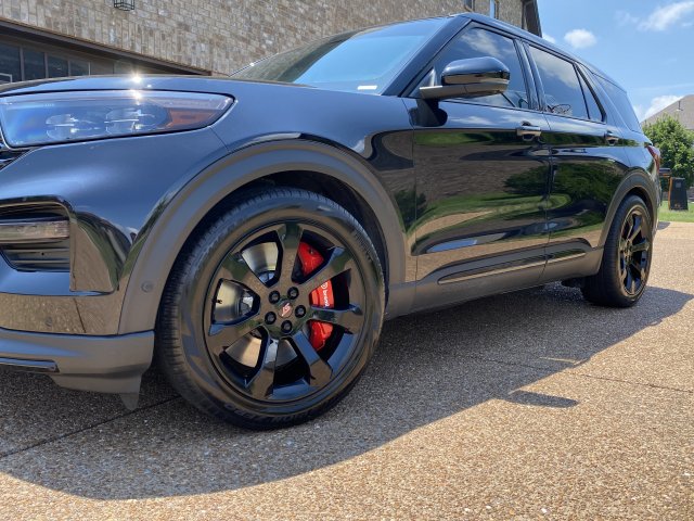

Thank you for your appreciation and good call on the 20” wheels maybe being a possibility. With how tight things seem with the 21” wheels I didn’t see how the 20” wheels would be an option, but I suppose that’s possible since the GT500 comes with 20” wheels so the rotors/calipers could fit. Someone is welcome to figure out that part along with what spacers are needed to make that work. I’m sure aftermarket 20” wheels would have a better shot of fitting well too.
Yes, you can definitely make 20s work but spoke clearance is essential.
