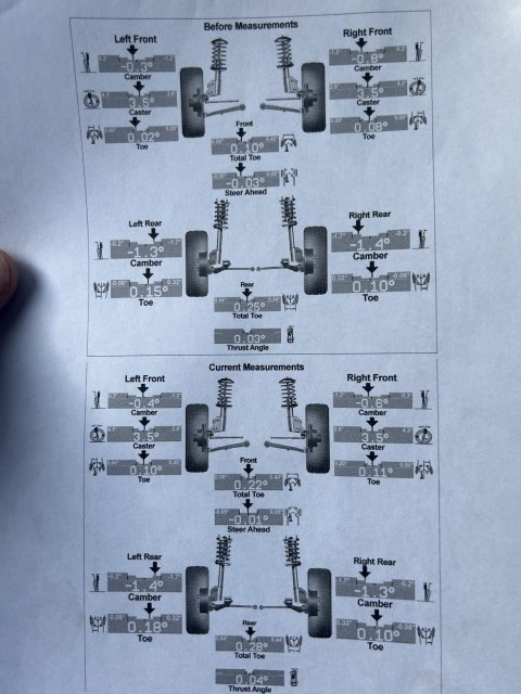

Update:
vehicle went into deep sleep mode again. Have been driving it normal and just got back from a 400 mile round trip. Battery tested agin by dealer with no issues.
They re-did the alignment and it drives much better. Still don’t have the original spec sheet for the alignment but below is the one that was done today.

Front looks great, camber on the rear is a bit too negative, closer to -.5 is what we'd like to see them hit.

Interesting. Before and after don't look much different.
