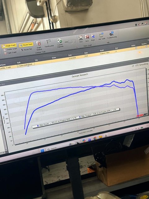

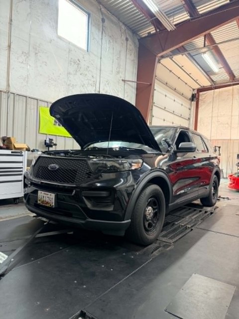

Ben reached out for tuning a while back. We finally got him on the dyno with a simple mod list:
Mods
Fenfab v2 intake
CVF intercooler
Catted downpipes
Fuel
93oct e10, so no added ethanol for instagram numbers
The results are unreal!
493whp 528wtq *on 93e10*!!!! You can see up top that we have reached the knock limit. But the power is incredible. On a cooler day this car will make 500+whp on 93oct!
I'd imagine this setup will make close to 580-585whp on E40. This car just flows!
Let me know if you guys have any questions!

59k on this one.
It made 330whp stock. I'll post the before chart when I get it from The shop
