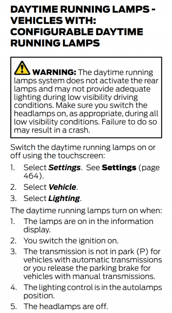

You think you can find a way to turn off the white DRL strip during the day? I am trying to leave the turn signals on without having the white strip light.
369
221
Airizona
#20
I'm pretty sure I have seen the setting in the options to disable the DRL's as it shows here in the manual. Would that not work?
