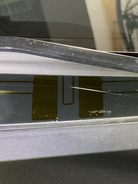

Took a quick look at my windshield wiper park heater grid. You can clearly see two fat tracings at the bottom of the windshield on the passenger side. There are ribbon cables immediately below, underneath the battery compartment cowling, that attaches to something behind the battery. Sorry, but that's about all i am willing to look into it for you. you would need to remove the battery to see what else is there.

Yeah that's what my new windshield looks like too. I wanted to play around with forscan today after work, maybe some other day I'll pull the battery and see if I can find the other side of the connector.

Did you ever see if the windshield is connected? My new windshield has the lines in it too. I took a quick look but didn't see the end of the wire that goes behind battery.

Yeah, last Saturday I pulled out the battery and battery tray and no the other end of the harness is not there. I would either have to make a stand alone circuit or tie it into the heated mirrors to get it to work.

Gotcha , I have a 2020, I'm not even gonna bother pulling the battery then. Thx
