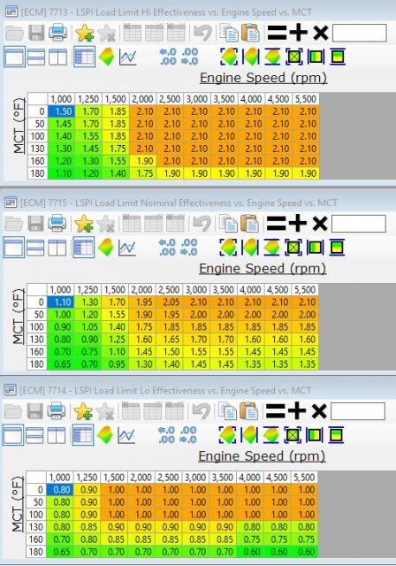

I've been tuning my own cars/trucks/motorcycles and the occasional friend's vehicle (bourbon is currency) since 2004. The method Ford uses for keeping your engine in one piece while balancing performance is pretty bad ass!
I'll keep it simple:
Based on the average of how often your knock sensor is active (octane and fuel type/quality do matter) it blends between three tables, from mild to wild. I attached a picture where "wild" is on top and mild on the bottom. Even if you were running a fuel with an octane rating of infinity the MAX table will still dial back load (airflow/spark) based on the Manifold Charge Temperature (MCT). MCT is the air temp measured after the intercooler. As you can see a cooler MCT gets a higher load value...thus why an intercooler upgrade can improve performance even on a stock tune.

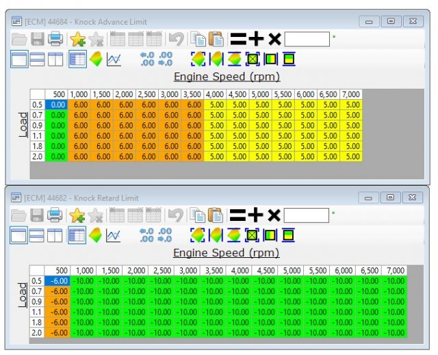

Additionally, ignition timing is constantly being adjusted based on knock activity. There are a lot of variables to this but keeping it simple I have also added a picture showing you how much spark the ECU can add or subtract on the fly...the ADD part is pretty bad ass.
I've never read and compared a stock tune to a FP tune, so I don't have scientific evidence that Ford didn't negate all of these strategies from their "Performance Tune". BUT, it would literally take more work to remove them than to just leave them and turn up the wick on the "max" and "normal" tables.
If anyone with the FP tune lives in southern LA and wants to know for sure, shoot me a message and we can put it to rest.

It’s “LSPI” tables. I know you know, but…. Anyway, your screenshots are from the HPTuners software for those that may not know. The Cobb Tuning software tables are essentially the same. I have/use both so…
