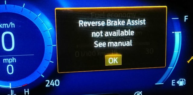

Good afternoon
I'm from Moscow, we don't have dealers. If anyone can go to their nearest dealer and find out what to do, what to repair in my car. Or maybe someone has come across this.

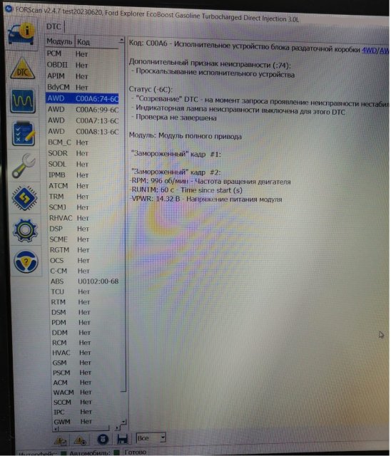

Ford explorer release 07.2020. When starting off, the car twitches (at low speeds). Errors pop up both during acceleration and when coasting, in rain, dry weather, or they may not pop up, but it always twitches. When the engine is restarted, the errors are reset. Errors in the application.
Thank you

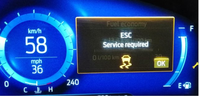

No idea what those diagnostic codes say since I don’t read the language, but based on those dashboard pictures it could need a replacement all wheel drive control module…those messages (and a few more) came up when mine needed a new module.

I had a few messages today along with drive mode not available at 41,500 miles. After a restart, the 4wd fault stayed on but the others were gone. Probably what mine needs is the module. I have an appointment tomorrow. I have a FordProtect ESP with rental car but this may be under powertrain warranty?

Hbalek, this is for cars until February 2020, I have July 2020, don’t come to me, but I tried to change the sensor, it didn’t help.

It has not been diagnosed or repaired yet. They have had my car since yesterday. I'll update as soon as it's repaired. Someone on the other ST forum had his AWD module replaced for the same type of malfunction.

Mine was repaired today and it was replacement of half-shaft speed sensor. It was covered under powertrain warranty so there was no charge or deductible on ESP.

I changed the sensor, even tried two, from other st, it did not help.

Sharapov, your problem is not the speed sensor. The car drives fine when the speed sensor is faulty--you just don't get the features. I would think the hub actuator bulletin that you posted might be a good place to start. When is your build date? At some point the deleted the electrical port to the hub actuator.

So far so good. No 4wd fault messages and it drives normal. Besides replacing the sensor they cleared codes and topped off fluid. Here is the work they did in the attached document.
Also, the TSB they applied is this one:
21-2270 Ford Technical Service Bulletin (tsbsearch.com)

Cdubya, assembly 07.2020. There is an AWD module, I'll try to change it, but there is nowhere to get the hub actuator (((

The AWD module did not help, they changed three pieces, updated the firmware, etc.
Problem still exists
