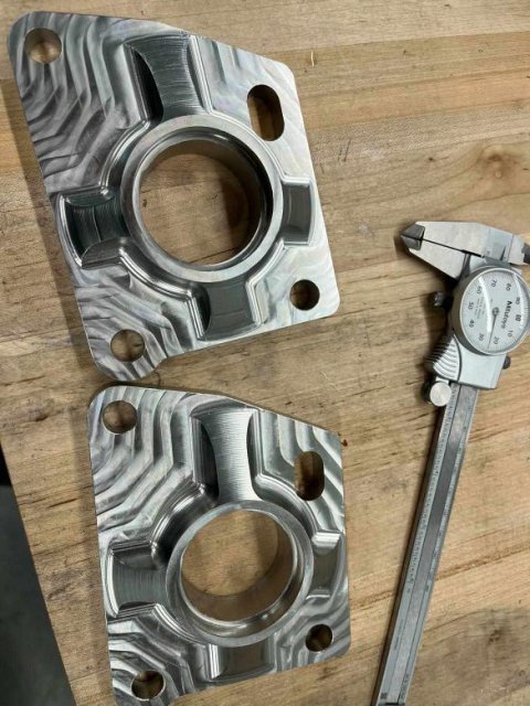

Ive been trying to research everything. I’ve got a set of exhaust port manifolds “ordered”, but not sure of completion date. I’m thinking the Borg Warner 9174 with internal waste gate to minimize plumbing. What are your thoughts?
