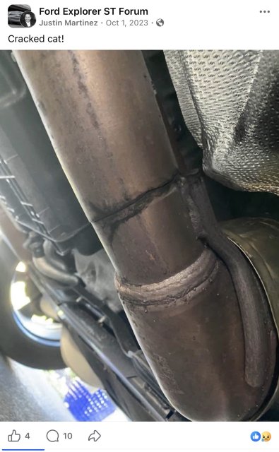

Usually they crack right at the weld or in the heat affected zone. But quick search does find other threads where it looks like it cracks in that same spot with a pretty straight line
https://www.explorerst.org/threads/catalytic-converters.5041/

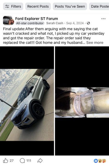

Edit: here’s a post on the FB groups. Same spot. Maybe email these to your service advisor IMG_9730.jpeg
