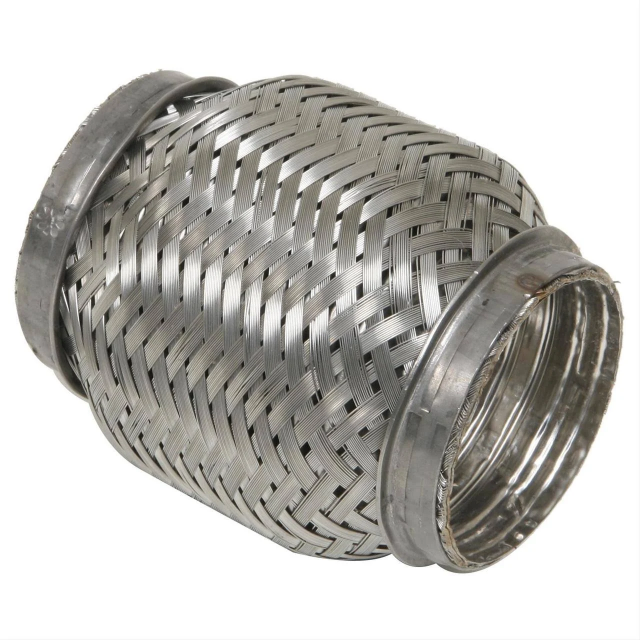

Do you have photos of the new flex pipes? What did you replace the stock ones with? Better mesh ones or straight pipe?

I replaced Ford's stupid mesh with the traditional woven style. I just ordered the Thermal mid-pipe kit from whoosh as it already is designed to fit to FenFab or SPD downpipes and welded it up to my existing cat back exhaust. Comes with new 2.5" midpipes and the good flex sections.

I checked up on a company called Vibrant and they sell the flex pipes with either 6" or 8" configuration but idk about additional piping to attach them (still new to all of this).
