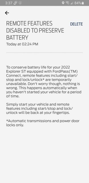

So after the keypad shutdown again after just a few days I decided I would test the 14 day everything shutdown. Exactly 14 days to the minute after the last time I used the car I got a Ford Pass notice saying all remote access was disabled and those icons were gone. Then with the key fob in my pocket the door did unlock when I touched the handle, and then after I activated the car the remote features returned along with the keypad. Just something to know.
