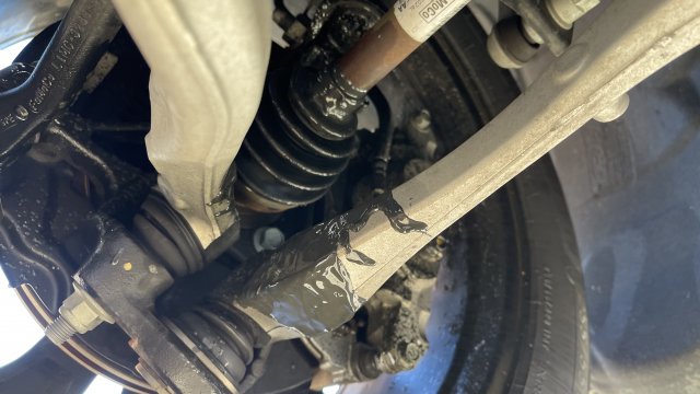

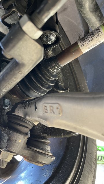

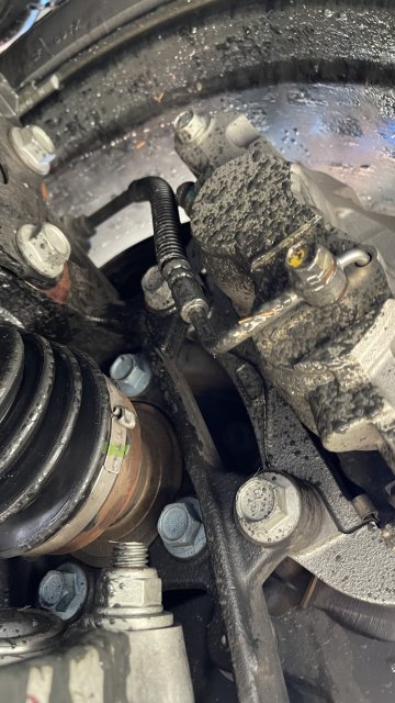

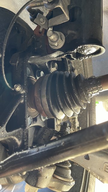

What is the likelihood or having both front CV boots torn? What would be the cause? I haven’t ran over anything, which leaves me totally confused.

That is very strange. Did the clamp break or is the actual boot split?

On some explorers they tightened the small clamp on the outer boot too tight and the boot tears. Ford Boss has a youtube video if you want to search.
