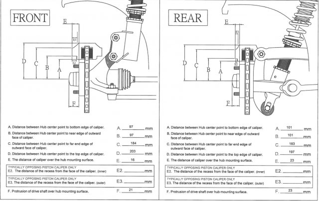

Posting these numbers here...maybe it’ll be useful to someone in the future. My wheel builder required these measurements so I’m sure others will too...now you don’t have to take your wheels off and measure for yourself.

Those numbers will be required for a custom wheel build. I'm having a set of 22x10.5's built.
