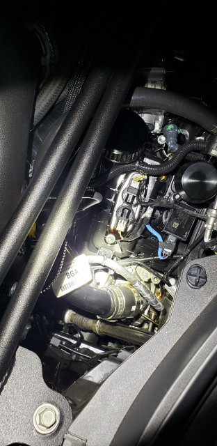

Anyone reccomending/ using a crankcase breather?
Anyone using one and having oil leak/ pooling on the engine?
I have the UPR Crankcase breather and I am experiencing stand/ pooling oil. Is this expected or normal? I have double checked the fastener between the valve and the filter. It does not seem to be the source of the oil but the filter stays very saturated. New to forced induction engines and only have about 2k miles on my 22 ST. Thanks for any help or advice.

I doubt you'll find anyone with an open element crankcase breather. There's a reason everyone uses a catchcan setup.

Can you let us know why you’re running one?

You just found out the hard way that open element breathers have no place on modern engines. Not only will it spit oil all over the place, if it's close to the HVAC fresh air inlet, you can get smells into the interior (and they aren't pleasant)
PCV offers many benefits to our engines, with the only downside being oil into the intake, and that can be countered with a proper closed-loop catch can (Mishimoto, JLT, UPR, etc)
Theoreticle alternative to a catch can and ignorance I suppose.
Theoretical cheap alternative to a catch can and ignorance I suppose. Looks like its the catch can route at this point.
