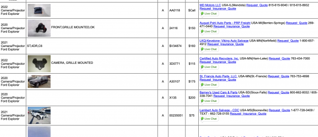

Sure thing...good luck with the replacement. Where did you find the camera?

Where did this listing come from? Could be very useful.
car-part.com
Great spot to look for used parts. Purchased quite a bit over the years.
