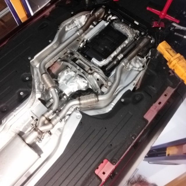

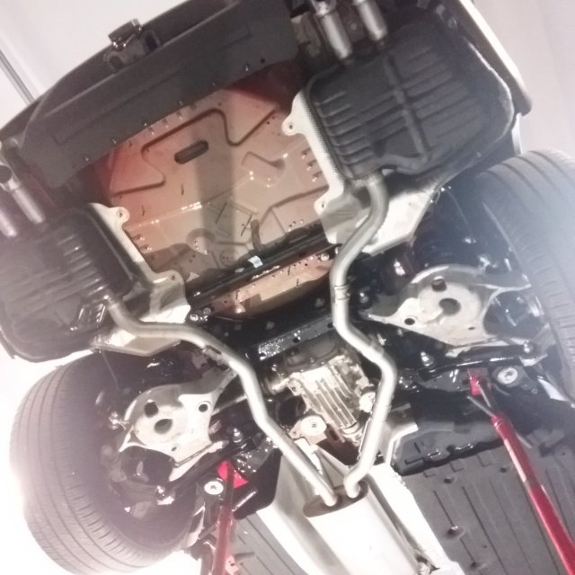

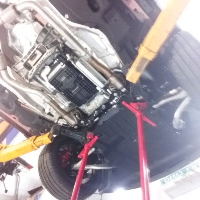

Local fluid film undercoaters offer hackery in about an hour, which is better than nothing, but I'm picky so I did it myself. Took about 4 hours. Lots of cavities to get wand into. Lots of guards and covers to get under too. Very impressive design components under there.
