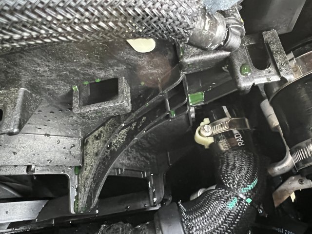

Then started and instantly saw the problem. Now with coolant in the radiator there was something to leak out.

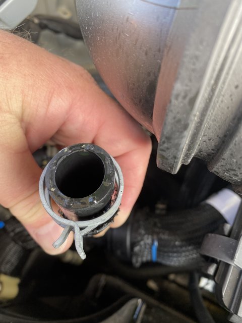

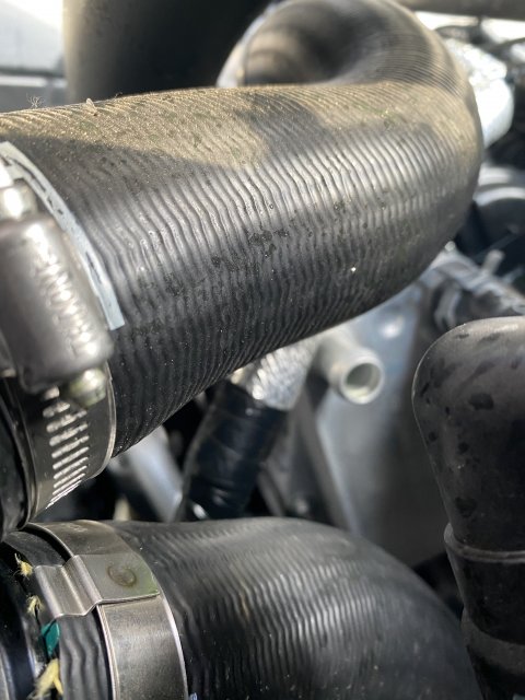

Can see hose detached. Where & what hose attaches to.
66B1516C-BE19-49C3-AD29-52B0B6BFF818.jpeg 706DE3A3-FA6C-43CF-8098-BC2AF09155CC.jpeg ADF5ACDE-4D49-4666-B888-A3DC1705104F.jpeg EE7FFFD0-985A-4D7E-A84B-34086C271719.jpeg 66B1516C-BE19-49C3-AD29-52B0B6BFF818.jpeg 706DE3A3-FA6C-43CF-8098-BC2AF09155CC.jpeg ADF5ACDE-4D49-4666-B888-A3DC1705104F.jpeg EE7FFFD0-985A-4D7E-A84B-34086C271719.jpeg

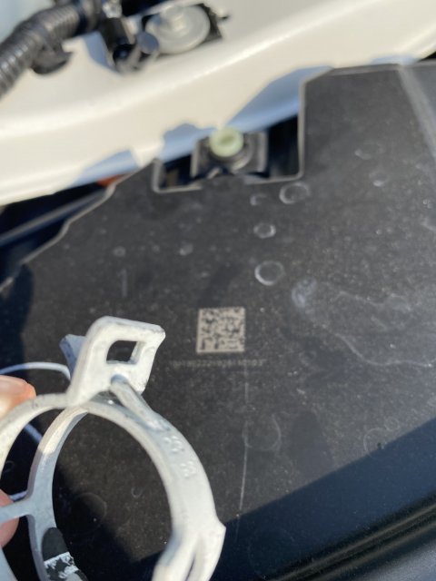

Hose clamp from factory locked open and not tensioned in place. Factory defect!
I replaced oem clamp with standard screwdriver adjustable clamp and secured in place where it belongs.

Finally know the name of the part that had the coolant line failure, it was the engine oil cooler. Specifically the output line off the oil cooler which T’s into the center section of the upper radiator hose.

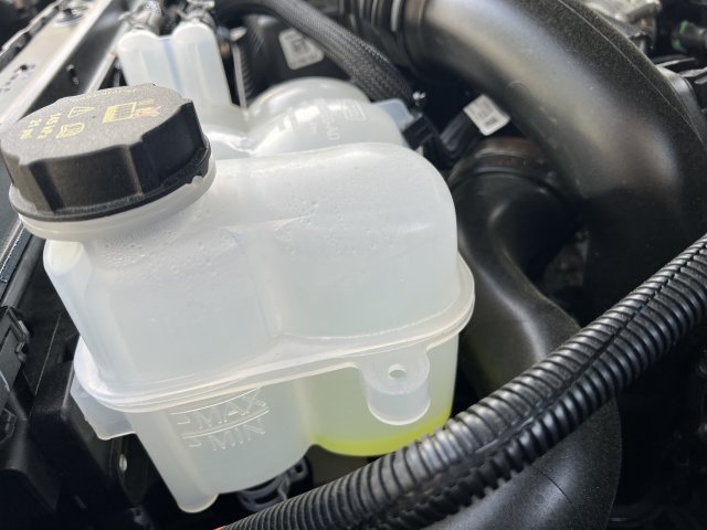

Reviving and old thread here as my 23 dumped it’s coolant last night. Short, easy 8 minute drive home from a friend’s house. No warning lights and temp was reading normal. Noticed smoke (steam?) rolling out from under the hood when I parked in the driveway. Popped the hood and coolant was everywhere. It was too dark for me to really see much of anything, but the engine was COOKING. Checked the hoses this morning and can’t see any that have came loose, but not exactly sure where the hose referenced above is located. Engine is COVERED in coolant. Luckily, my house is less than 300 yards from the dealership. I’ll run it over today and leave the keys in the drop box and see what they say tomorrow. Do y’all think I should add some coolant or water before I drive it over? Almost hate to as I want them to see it like it sits.
Coming from an 07 Eddie Bower that never left me anywhere - 22 days into ownership and I’m stranded. Just over 500 miles on the clock. Gave the old Ex to my father currently two hours away. Wife is out of town for work. What a mess.

Update. Vehicle was towed today. Exact same issue as OP with a faulty?? hose clamp going to the oil cooler. Replaced the hose clamp, checked the others, and washed the engine bay. You guys should probably take a peep at your hose clamps…
