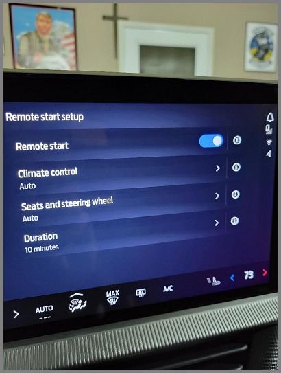

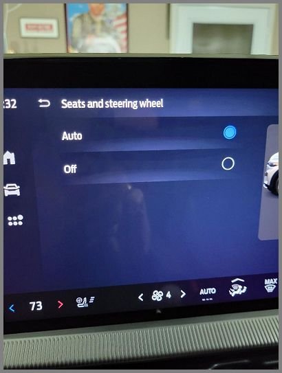

OK - will double checked my settings and here they are:

It works! I would like to apologize to everyone who jumped in to help. It was working this morning. The only difference was it was much colder than the few days before. Apparently, it simply was not cold enough to kick in the auto stuff during Remote Start. Thanks!
