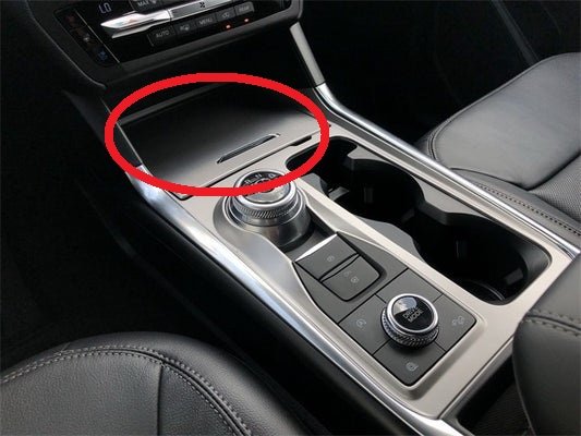

Does anyone know how to remove this lid permanently? I don't want to accidentally break this thing off (just in case I decide to put it back later down the road) attempting to remove this by trail and error.

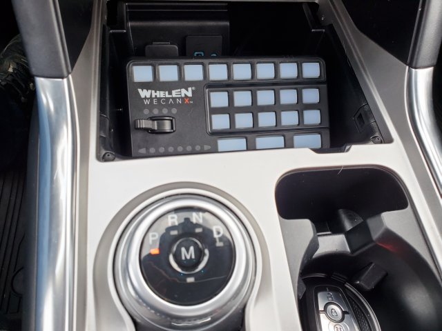

Take the whole console out, it's not difficult. A few bolts and trim clips. Instructions are out there and in the service manual, which I suggest investing in. You can access the door/cover from underneath the console to remove. I broke it taking it out but it wasn't necessary to remove. I just have no patience and I knew I wouldn't be needing it any further. For my install I mounted a Cencom core control head in the pocket. Power is right there for the accessory plugs. You can use forscan to modify the time out time on them to keep them powered after ignition is turned off. 20210428_170952.jpg

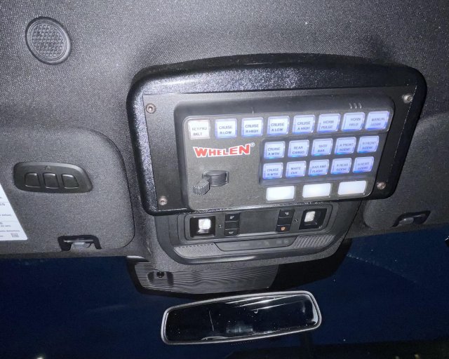

@SFD295 , that's a cool setup. I got too lazy to take apart the center console. I opted for an overhead mount using the Havis overhead console mount for the Ford PIU's. Same bolt pattern footprint and turned out to be a really clean install. P.S. Don't mind my custom button legends on my CenCom controller LOL.

Take the whole console out, it's not difficult. A few bolts and trim clips. Instructions are out there and in the service manual, which I suggest investing in. You can access the door/cover from underneath the console to remove. I broke it taking it out but it wasn't necessary to remove. I just have no patience and I knew I wouldn't be needing it any further. For my install I mounted a Cencom core control head in the pocket. Power is right there for the accessory plugs. You can use forscan to modify the time out time on them to keep them powered after ignition is turned off. View attachment 14609
Nice install! Which module and what settings did you change in Forscan to modify the timeout time? Been trying to find them without any luck.
