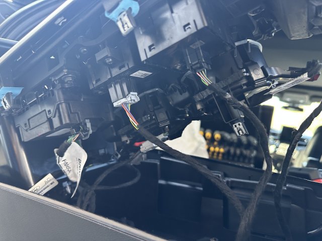

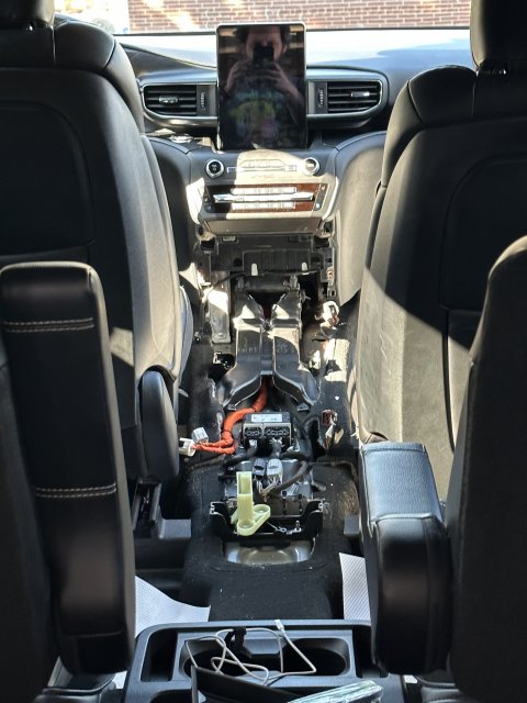

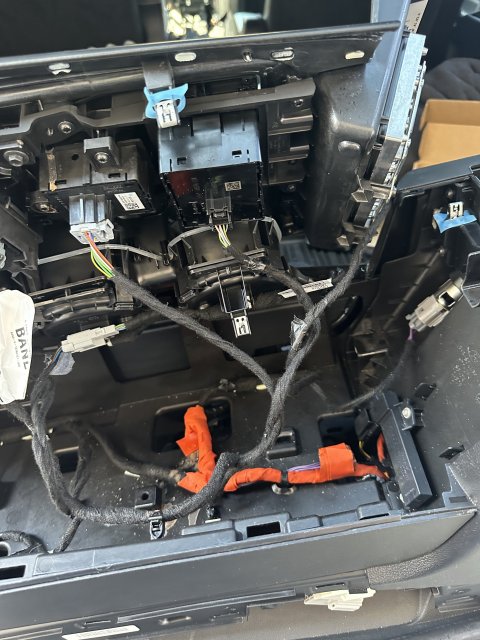

Noticed the front cup holder was busted on one side after purchasing it last week. Bottom was only held on with little plastic rivets. Ended up using a soldering iron and fusing the pieces together. YouTube helped me remove the console, but provided no help accessing the cup holders. It comes apart front to back.
Hello TBonics
I would like to foil the silver console in the middle and remove it for this, in your pictures it only looks clipped, is that right? or do I have to remove the entire middle console to remove the silver part?
T
TBONICS
East Canton, OH
Hello TBonics
You have to pull the entire console out. That's not that bad. Once you pull the console back you have to pull the silver trim from the forward cubby to the rear.
