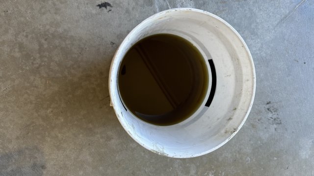

This is what the fluid looked like. I assume it’s associated with my previous seized caliper issue, which was also RR.
