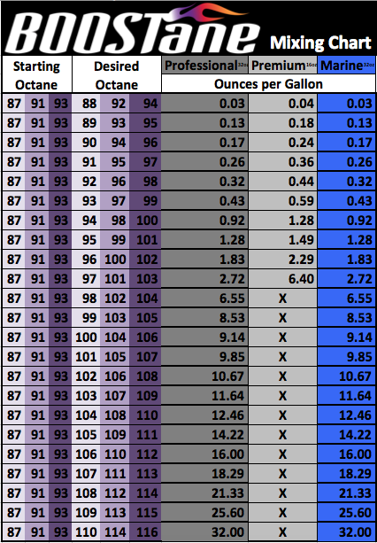

So here’s the deal...Boostane doesn’t add power. What it does is add verifiable octane numbers so the car will see less knock and can add all the timing the car is capable of with the tune it’s running. You can get a 93/Boostane tune that’ll add even more power.
I’ve ran the Pro for years...I buy it by the case. The stuff works. I picked up over 30hp at the wheels on a 93/Boostane tune in my blown F150 over the daily driver 93 tune.
It’s good to keep on hand on a road trip too if you’re tuned for 93 and run into a 91 only state. Just a few ounces per tank will get you back up to 93.
It doesn’t take much to make a difference. AE345C29-A6AA-47C1-9768-115747A208E6.png

who does a 93/BOOSTane tune? I’m actually using Petro Canada 94 octane whenever I fill up so already pretty high number. Livernoise tune is a beast!
Anyone else have experience with BOOSTane Octane Shot?? Seems more convienent and also thinking I can throw it in the Harley...two birds - one stone.!
