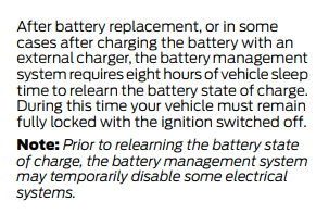

You do it while parked with the ignition on but not powered yet. There are some pretty convincing Ford techs that claim it works, and if you follow the procedure you do see the battery icon blink. I did this in my Mustang a year ago after replacing the battery, which straight up died and resulted in electrical conservation stuff (like passenger side lock wouldn't function I think), so it seemed to work.
Check this ford service content: https://www.fordservicecontent.com/...a&div=f&vFilteringEnabled=False&buildtype=web
Plenty of other Google hits on this.
From the owners manual.
