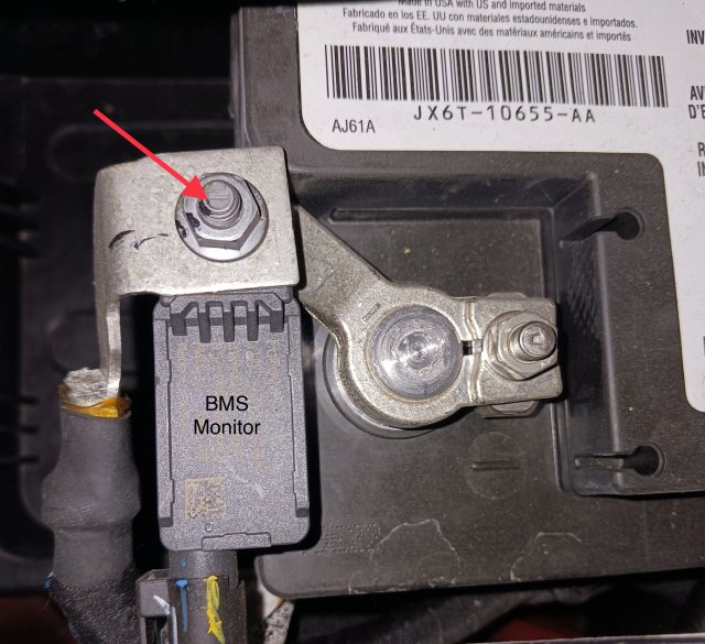

This is the proper location for your negative battery cable … on the backside of the BMS Monitor While charging the battery… I bought my 2020 Explorer August of 2019. I still have the original battery… connecting your negative battery cable on the backside of the BMS enables the BMS Monitor to recognize it is receiving a charge. connecting to the front Side of the BMS is incorrect. 20230808_222603_Original.jpeg
