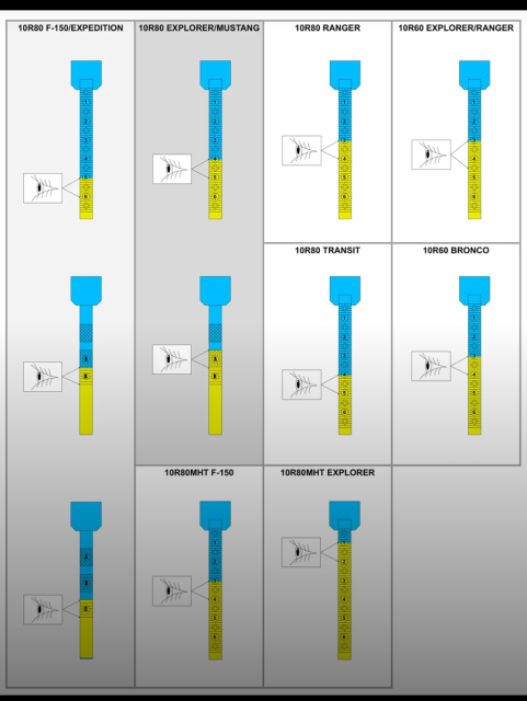

Full level: 3 - 4.5 on the mini dipstick (temp 206-215F). I would recommend 2.5. Make sure also that engine is running, in neutral, and after cycling through R and D several times, and car is level. Also when topping off, I'm going to guess it's a little more than a 1/2 qt to go up one point on the level, so start there.

Location of trans fill plug--view from Driver's side, above trans cooler. The mini dipstick underneath that.
Fill plug and mini dipstick: note the numbers in circles 1 - 6.
My level: 2... overfilled.
