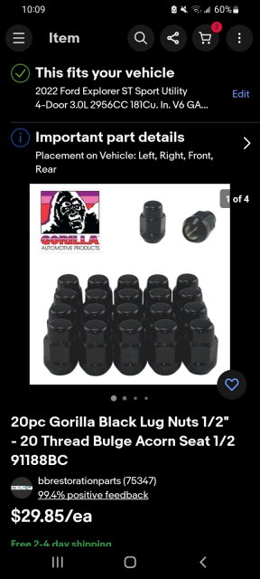

So I will be another person to say, these vehicles should have come with black lug nuts. Well they didn't and no use complaining about it. So, searched around the net, and obviously found Ford Performaces lugs, but the $195 sounds a little steep to me. I found these for $30 from Gorilla (who I have heard good things about). Now I don't want my wheel to be coming off, so if I have to spend $195 then that's fine, I'm just wondering if these ones from Gorilla will be fine.

Wrong thread size, the 20+ explorers use the larger 14mm x 1.5 thread. Find a set in the correct thread and you should be good.
I just checked amazon and a set of gorilla nuts in the right thread size is a 130 bucks.

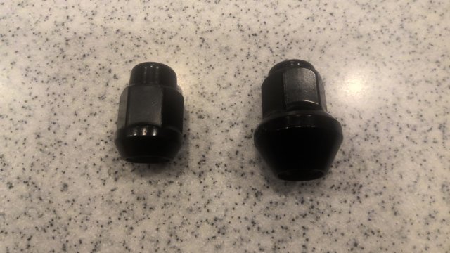

They'll fit, they are the same diameter, pitch, and shoulder taper but the Explorer and Mustang lug nuts have different shoulders on them. The Explorer uses the larger bulge shoulder than the Mustang. Ask me how I know. eBay's application pages show them to be different. I'll try to get a picture up. It simply comes down to the surface area that makes contact with the wheel. I'll try to get a picture up. Here's another thread on this:
https://www.explorerst.org/threads/conical-seat-angle.4143/#post-53719
1,907
1,627

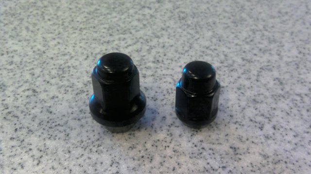

These are both Gorilla lug nuts. The larger lugnut is for the Explorer and Trucks and is the same size as the chrome ones that come on the vehicle. The smaller one is the lugnut mentioned early in this thread. I know firsthand that the one on the left will fit Edge wheels whereas the larger one will not fit in the stud hole. The splined lug nuts come in the same configuration.
Don't get me wrong. Both of these lug nuts will fit a 14mm 1.5 pitch stud. If you go to a tire shop and buy a specific wheel they may require a smaller seat as the wheel may have a smaller lug nut hole. Some people like to see the lug nut recessed and may choose the shorter one. If you're using the Ford wheels you might want to consider what was designed for the Ford wheel, then again maybe not.
Take a look at eBay's catalog, it's easy to use but does show these nuts for different applications.
Good call out. I run the larger ones when the stock wheels are on and the smaller ones when the aftermarket wheels are on.
Not disputing that there is a difference, in fact just looking at the still-installed OEM nuts and the Mustang nuts it's quite obvious that there is, but it is interesting that Gorilla, McGard, and even Ford Performance all list the same part number for both the Explorer and the Mustang.
I believe they list this the way they do because it is wheel dependent. Some wheels, like the stock ones, have room for the larger nut, and some aftermarket wheels do not.
