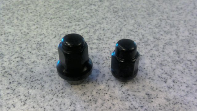

@ferneyhough, I think you're looking for a big bulge lug nut. These have the bigger shoulder at the bottom. The big bulge (acorn) on the left and peanut on the right was common terminology back in my shop days. These two lug nuts fit the same lug stud but not necessarily the same wheel. Having said that, I've seen the smaller lug nut installed many times where the larger one is designed to go. Get all the contact surface area the wheel will allow.

@ferneyhough, I think you're looking for a bulge lug nut. These have the bigger shoulder at the bottom. The bulge on the left and peanut on the right was common terminology back in my shop days. These two lug nuts fit the same lug stud but not necessarily the same wheel. Having said that, I've seen the smaller lug nut installed many times where the larger one is designed to go. Get all the contact surface area the wheel will allow.

GearHead is correct you want the "Big Bulge" lugs they are revised for heavier trucks SUVs and you are correct also you want the cone shaped ones.
Will it hurt if you get the smaller ones? I doubt it but they made them bigger for a reason. The one on the left of his picture is what you want. I just started research on them also. someone said they are 14mm and 1.5" long no idea on that thats just what I read somewhere. I think I am going to get the ford racing ones to me they look the best (simplest) I am not buying wheels for this SUV so the extra $50 wont hurt me, lol. Let us know what you go with please.
14X1.5 is the metric size. 14mm stud, 1.5mm thread pitch. I run 1.32” long lug nuts…I don’t like them sticking out.

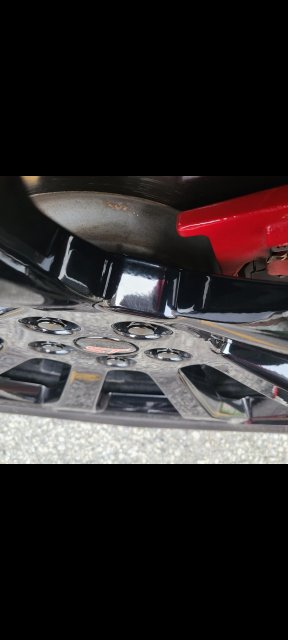

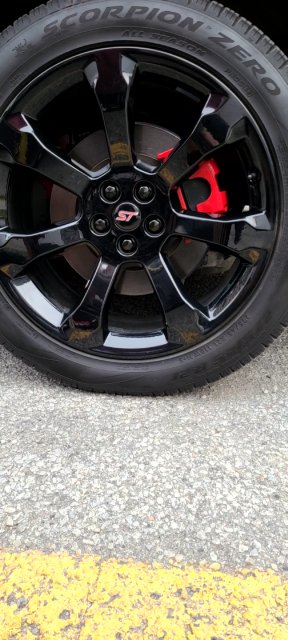

Ok so as promised I got these bad boys today & got them installed. I am absolutely amazed of the quailty for $69 total canadian. Here are a few pic's. Also they are exactly the same size as the oem & do not stick out one bit. Don't mind to semi dirty rims lol. They came all individually bagged in sealed bags.
