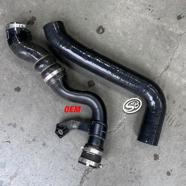

ANYONE running SBfilter hot & cold side piping??

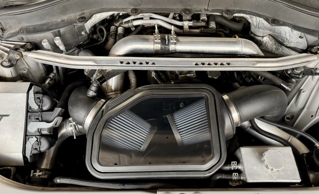

Yea mine I can hear now but before I cut the hood I’d have to roll the window down to make sure the Turbosmart valve was even working.

Looks like I’m going to go with FenFeb hot side and cold side with the TurboSmart BOV. It’s a bit more expensive but from everything I’ve read it’s worth it. How difficult is it to install this? I know it doesn’t come with any instructions.

Super simple, should be able to find some YouTube videos out there

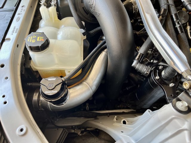

If you find a video, please share cause I’ve never found one for the hot side. I struggled like hell to get the piping on passenger side pipe to turbo lol Cold side was a 5 min install

Ahhh yes the driver side turbo, that’s the first piece that needs to go on then the cai. You need to find T handle 7mm/8mm/9mm/10mm tool. Mine is from my Armma RC car.. allows you to loosen the clamps and they are very compact. I pulled off the coupling that came on turbo and secured it to charge pipe the attached to turbo.

Driver side was cake, it’s the passenger side that I didn’t get along with lol
Mac, did you get an extra clamp piece that was smaller than the rest? What did you use it for?
