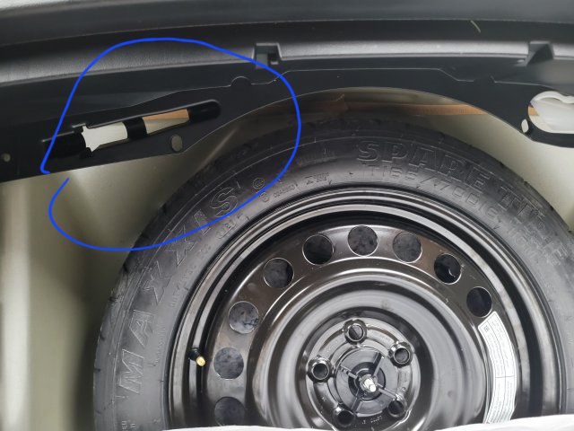

Anyone know what’s supposed to be in this empty space?
172
105
Gig Harbor, WA, USA
My buddy just bought a 2021 ST and he asked about this space by the spare time. My ST is in the shop so couldn’t compare. Anyone have an answer? 00352EDC-5656-44ED-821A-8C041DBCB1A8.jpeg

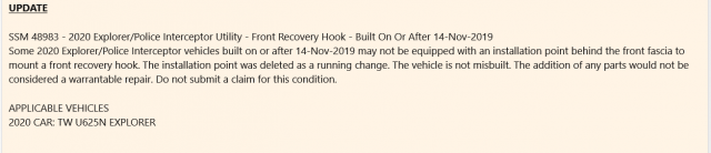

That was was for the front tow eye that was deleted during the 2020 year run. Ford just never changed the mold for that.

I bought the tow eye off Ebay for my 2020. It fits both front and back. My build date Nov. 2019.

Same here. I had to buy the hook but the threaded spots are there to use on mine.
