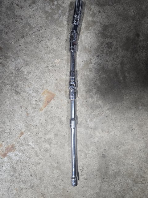

I actually keep the exact swivels and extensions for this job set aside. I have the exact formula to get into each cylinder with ease with one setup. Spark plug socket, swivel, short extension, swivel, short extension, long extension. Works for all 6.
If you remove the bolts that hold the AC hard lines in place you can do all 6 holes with a 6” extension, one swivel and a spark plug socket.
It was surprisingly very easy with the swivel. Getting that damn foam out was the hardest part. And figuring out the one clip on passenger side. It was a screw on with a zip tie instead of a pop off.. took me a bit to figure that one out
